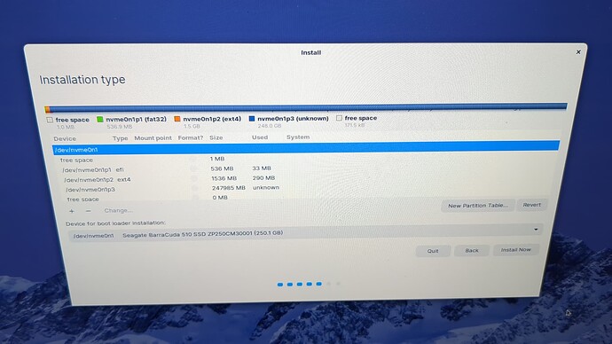

Alright, I've got to the screen.
Click on the line for nvme0n1p3

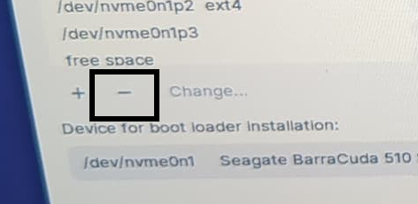

Next click in the (-) Icon as shown in the black square here:
partition-rm
This will remove that partition. It will now show as Free Space.

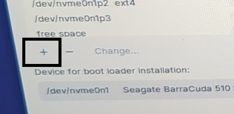

Click on the Free space to select it. Now, click on the add (+) icon:
partition-add

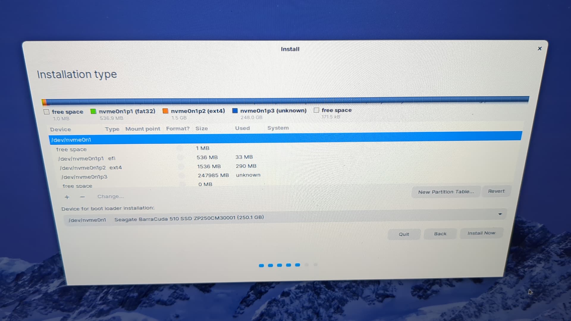

There isn't a line that ends with n1p4, it only goes up to 3
Typo... I would have sworn I bapped the 3 key... I dunno.

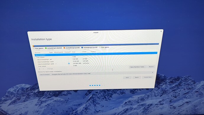

Okay, I've done it, whats next?
Click Install Now

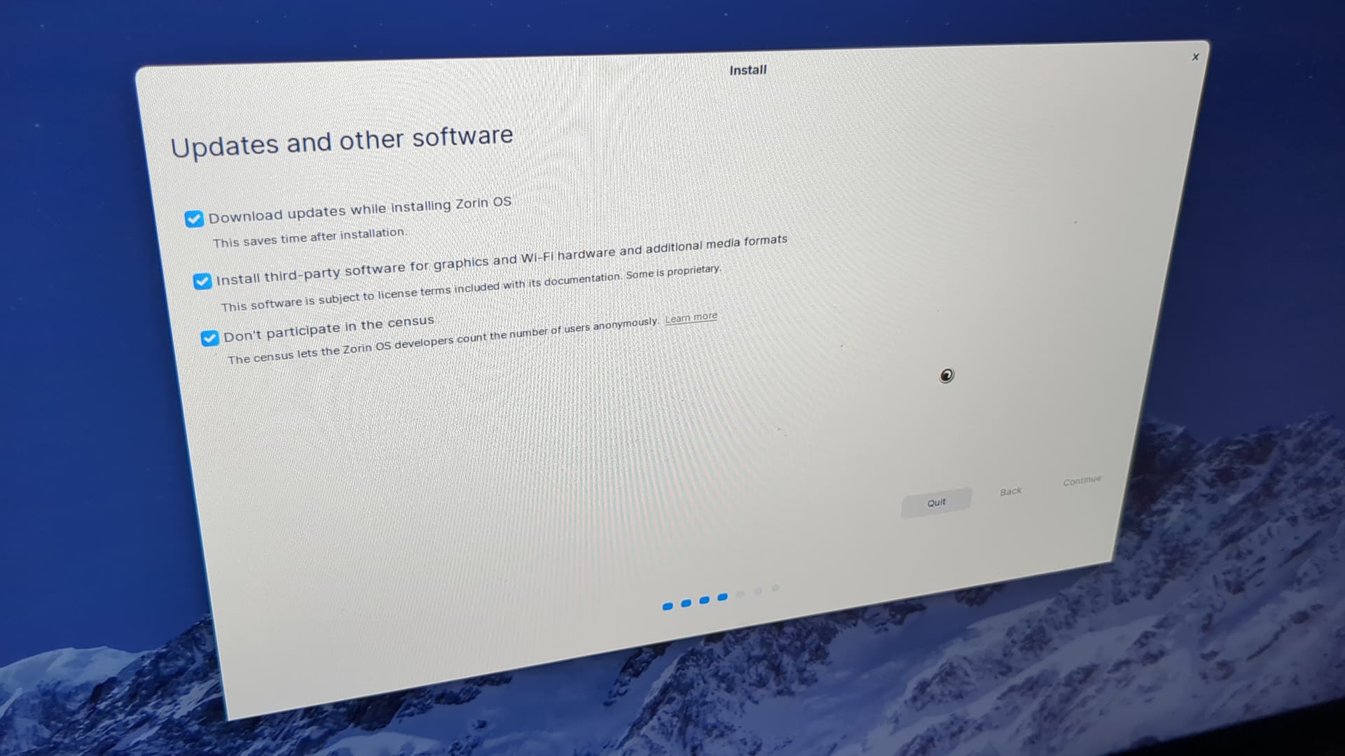

Im on the screen that says "who are you", and i presesed the continue button and the cursors just been spinning for about 30 minutes now.Anything that could be causing this?
Are you connected to net and had checked download additional drivers and updates as you install?

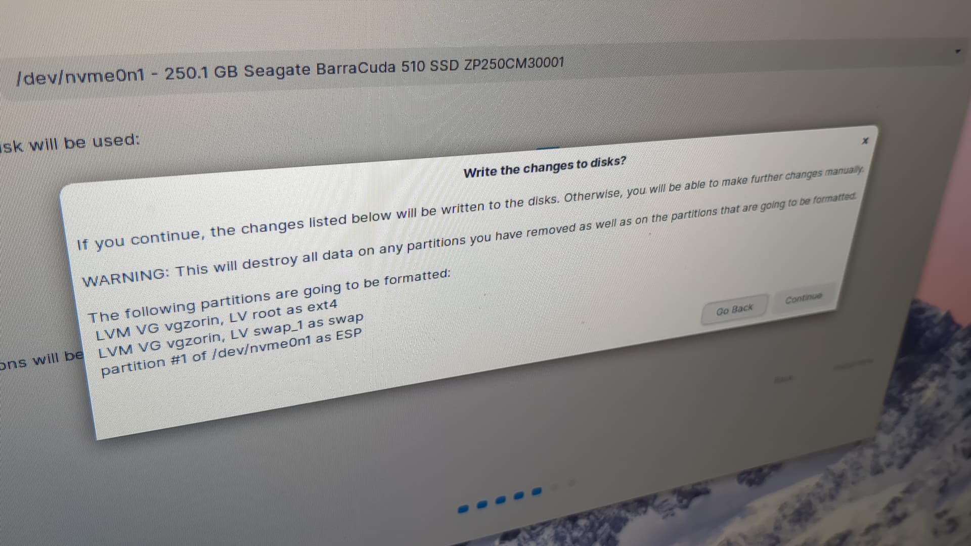

As for the installation, ive been trying over the past few days, only to get stuck for hours on end on this screen:
Have you tried running the install with the top two options unchecked?
Yep that's worked. Does this look fine?
