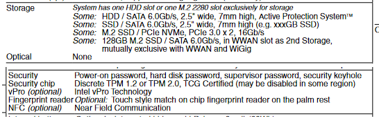

I have just been looking at sopec of Thinkpad X270 (extracts)
Lenovo X1
@Julie in BIOS look at Security settings, particularly TPM and hard disk password settings.
