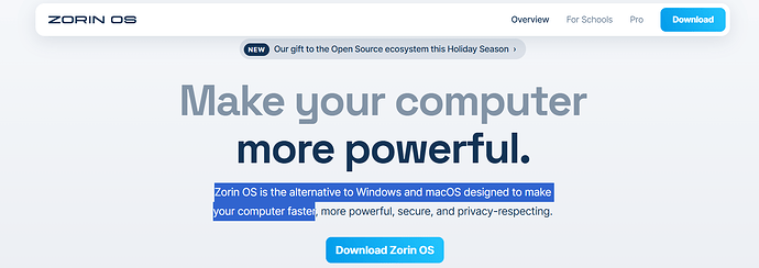

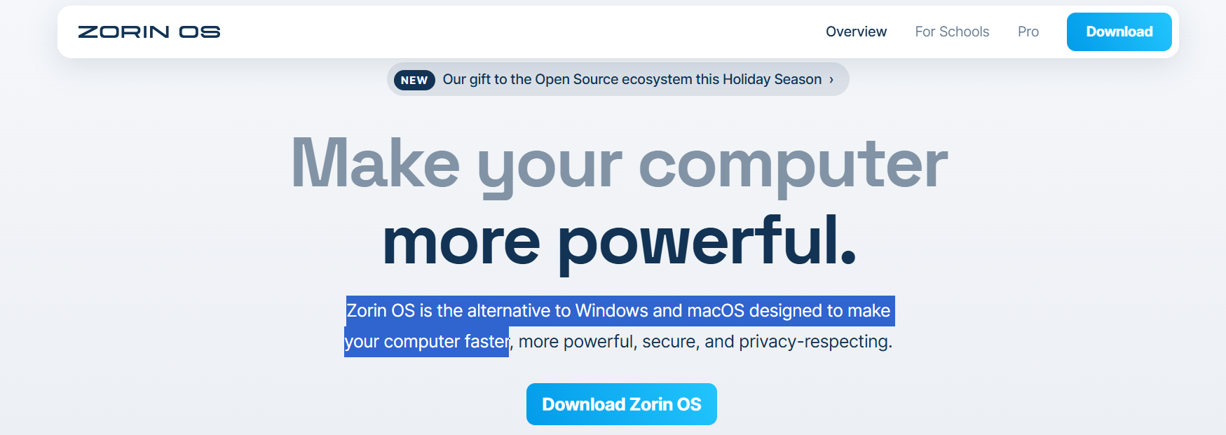

Hmm, I have no idea how to do that! But I'm also just surprised that ZorinOS seems slow compared to Windows 10 on the same machine, so with the same hardware. Isn't Linux generally supposed to be more lightweight and faster than Windows?
The Zorin website tells us:
Zorin OS is the alternative to Windows and macOS designed to make your computer faster
But is that actually not the case? Or did I miss something with my settings?
No, it could be but don't have to. It depends. Factors can be Hardware Support with Kernel and Drivers, what System do You use and what Desktop Environment.
Gnome for Example is with KDE a more heavier Environment. xfce is a more lighter one. So, it is not directly a common Fact.
