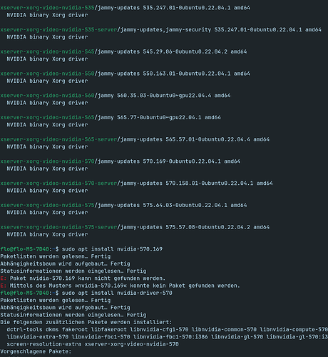

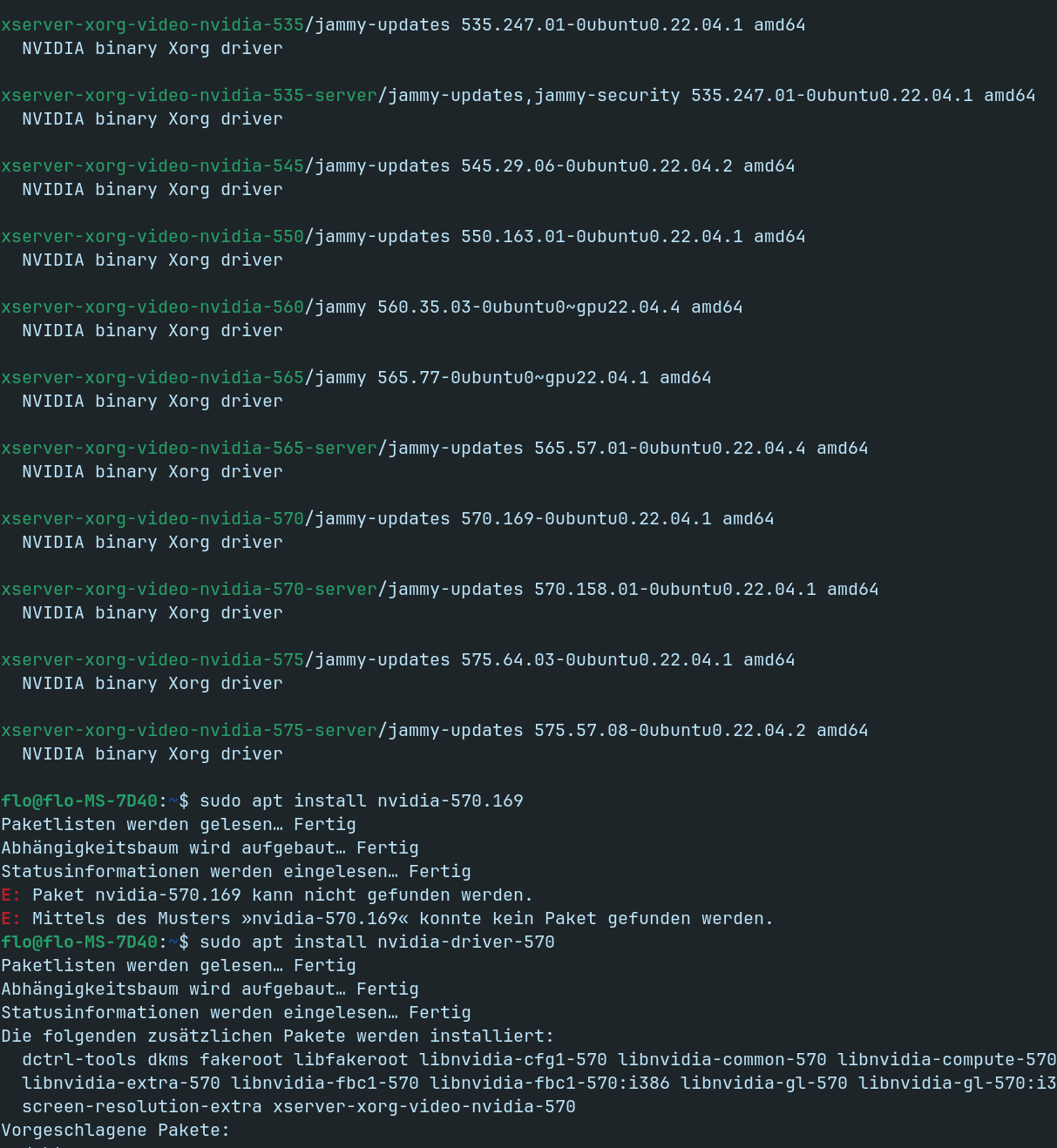

For those who need, the driver number is the number in the first portion of the driver version (xxx.xxx.xx).
Ex:
Here the driver number is 570.
I guess it worked! The only thing that changed is the driver name. Now they are called "nvidia-driver-570" or whatever type you need. The command
apt search nvidia-driver
gives you a nice list of driver names in green text. Choose the one you need! Beware of the headless options though!
