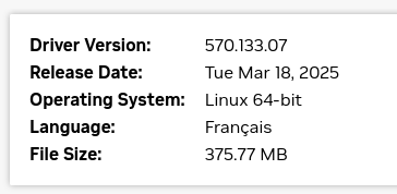

For those who need, the driver number is the number in the first portion of the driver version (xxx.xxx.xx).
Ex:
Here the driver number is 570.
