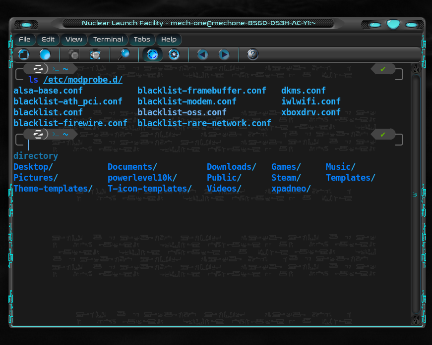

There is no directory by that name. There is etc/modprobe.d/ which is a directory, but is not named directory.
Are you able to post the output of
ls /etc/modprobe.d/
It should look similar to:
You typed the name of a file, outside of its location in the tree. that is not a command that can be executed.
