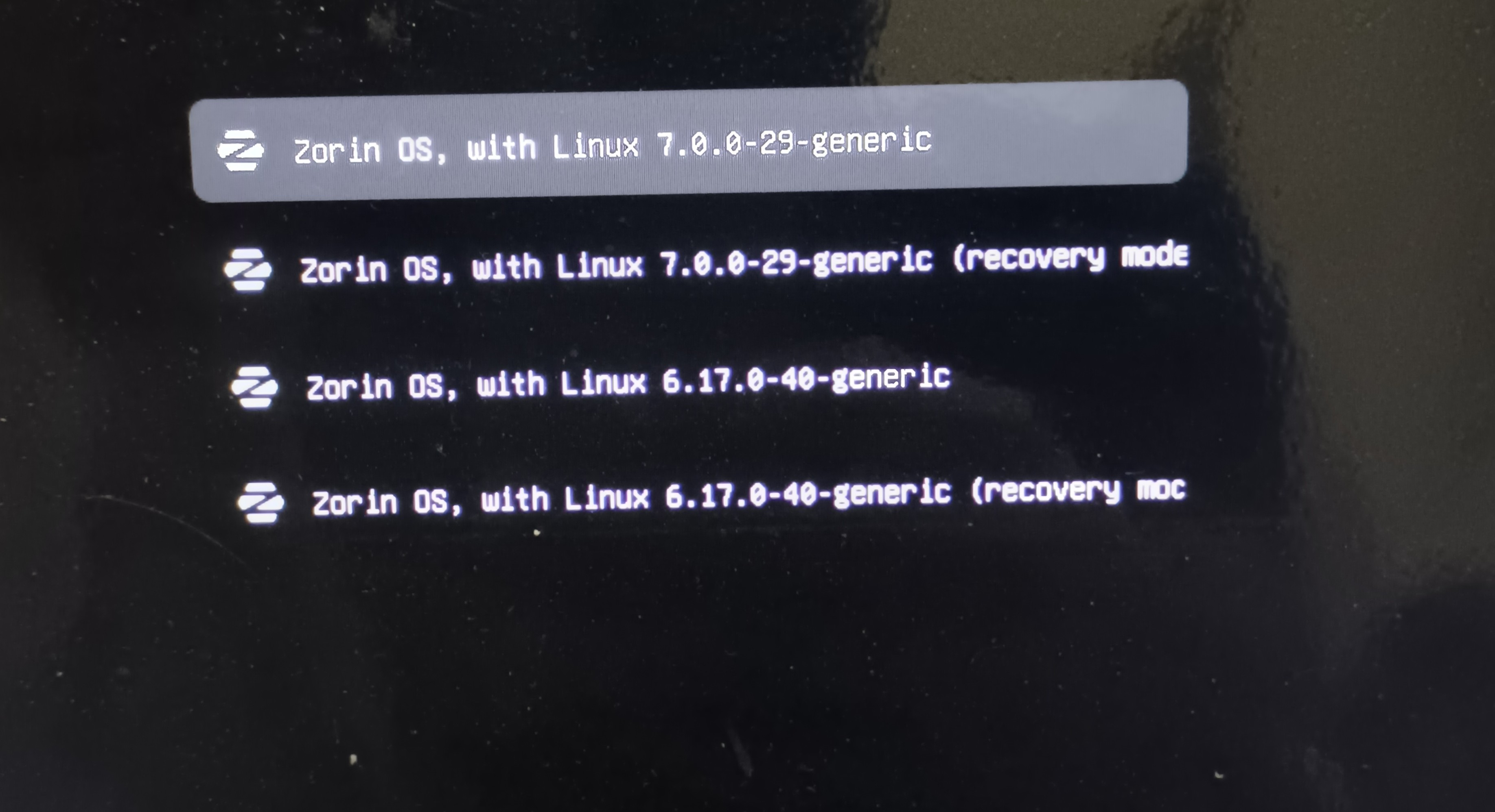

I have uploaded an image of the version which are currently installed.
The problem starts with 7.
Okay, thanks. Then it might be neccessary to stay on the 6.17 Kernel for now. @Nourpon already posted a Link with Instructions to se it as default. Another Option would be to install a newer Kernel.
