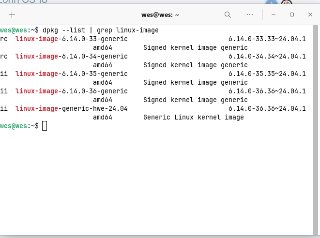

dpkg --list | grep linux-image
Thank you, wesoliv429! I tested it on my Zorin Virtual Machine and it works. There is a long list but the two kernels with ii at the beginning should be the ones which are still on my system.
I'll try later on my LM computer.
your welcome and yes the ones with ii are whats there the rc are removed ones

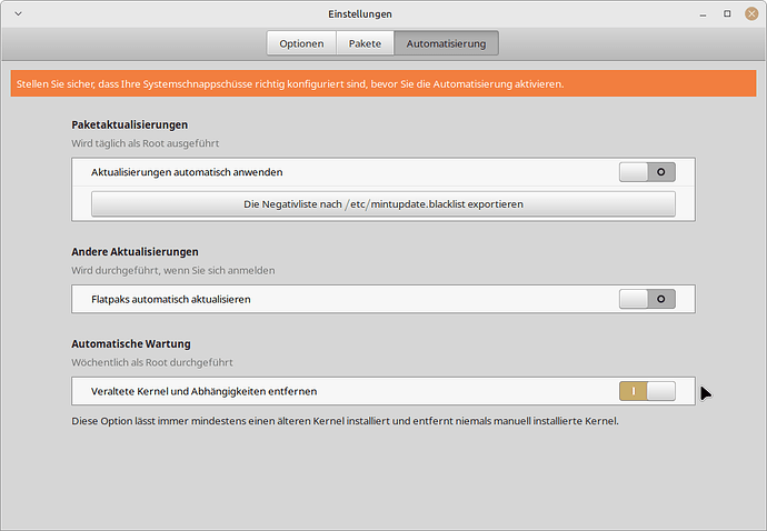

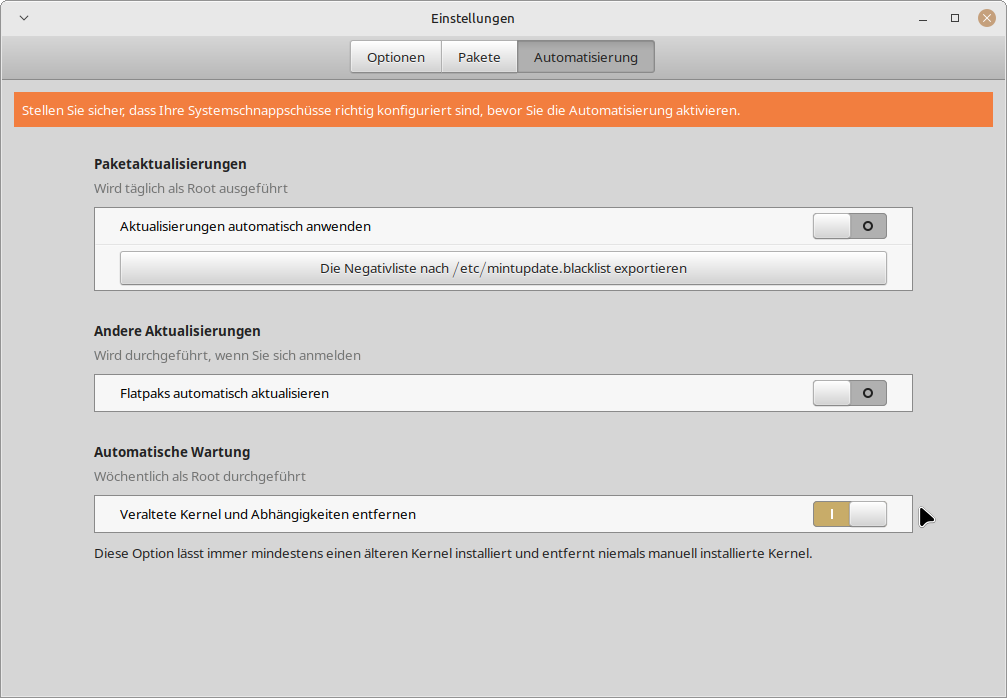

Does anyone know what I'm doing wrong, because my kernels are not being automatically cleaned up?
These are my settings. I don´t have enabled timeshift because it needs too much storage space. I'm not sure if it is required for the automatic maintenance.

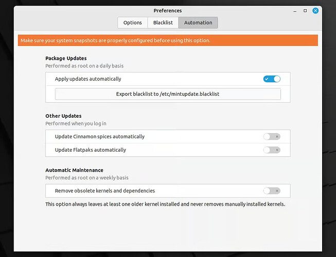

That is an image from internet with the window in English:
Those kernels in your LM machine, did you install them manually?
If yes, then the explanation is in the shared screenshot, the description line at the end: "...never removes manually installed kernels."
The kernels were installed with the normal system updates.

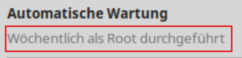

Then they should be removed automatically when the Option is enabled. But You can see that it will done weekly:
I believe it never happens. Can I check somehow if they are marked as manually installed? Maybe they are marked as manually installed because I initialize the update myself when I want to update something.

But just now I took a look at synaptic package manager and there are all my kernels listed as manually installed at category status.
So this is the cause why they are not maintained automatically and aren't removed with 'sudo apt autoremove'.
Probably I would have to change the settings for the updates if I want the kernels to be removed automatically.

the bottom 3 with the ii is what i have currently installed on zorin 18 pro...hope this helps some
