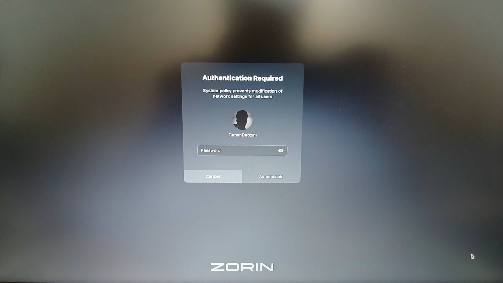

Yes, when I have my laptop locked and disconnected from the Internet. It usually requests root for something. I simply dismiss it and type my password to log in.

I can give you a picture by what I mean. I am not sure if you can see or not. You ignored the image I sent before.

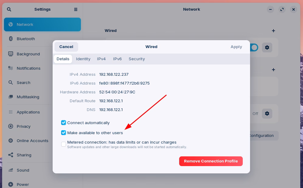

You can find it in Settings -> Network. The option in particular that Aravisian is talking about should be behind the little cog icon:
Note that in this screenshot I don't have Wi-Fi enabled, so yours might be different. If you're on Wi-Fi you would do the same but on the section that appears as Wireless or something similar.

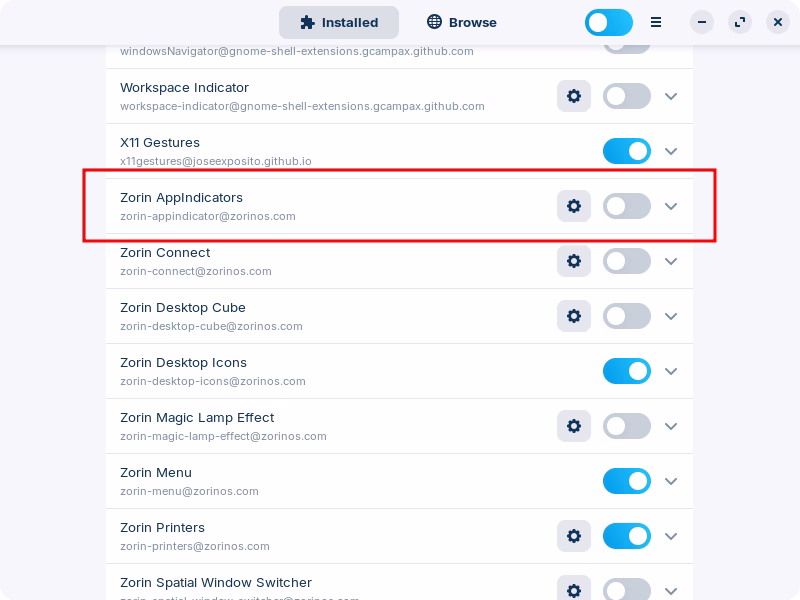

Now, from the previous log that you shared I noticed an error message that makes me think the culprit is actually one of ZorinOS's extensions. Let's try disabling "Zorin Appindicators":
I'm not sure what this extension does exactly, probably handles the system tray icons for certain programs running in the background and such. If you can live without that for a while, we could confirm this at least has something to do with it.
