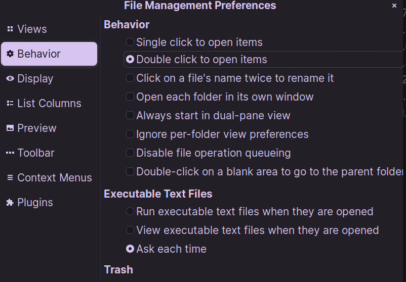

Also,in behavior there is no checkbox for bulkrename

finally i managed to get "double click to rename" working, for which i had to switch option from "single click to open files" to "double click to open files"
