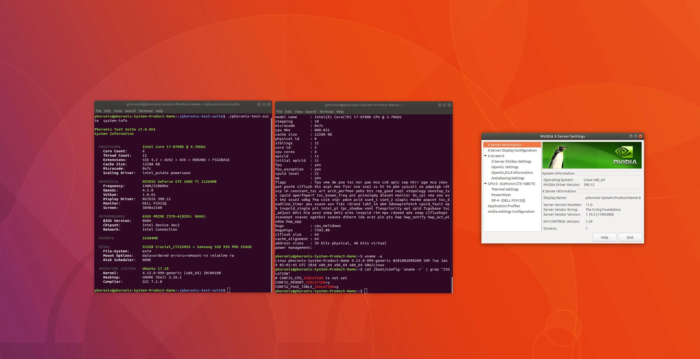

The NVIDIA 390 Driver Is Playing Nicely With Linux 4.15 Kernel
It will also on 5.11
Maybe he find there instruction how to properly install this drivers.
