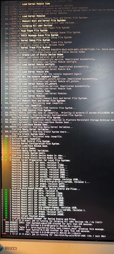

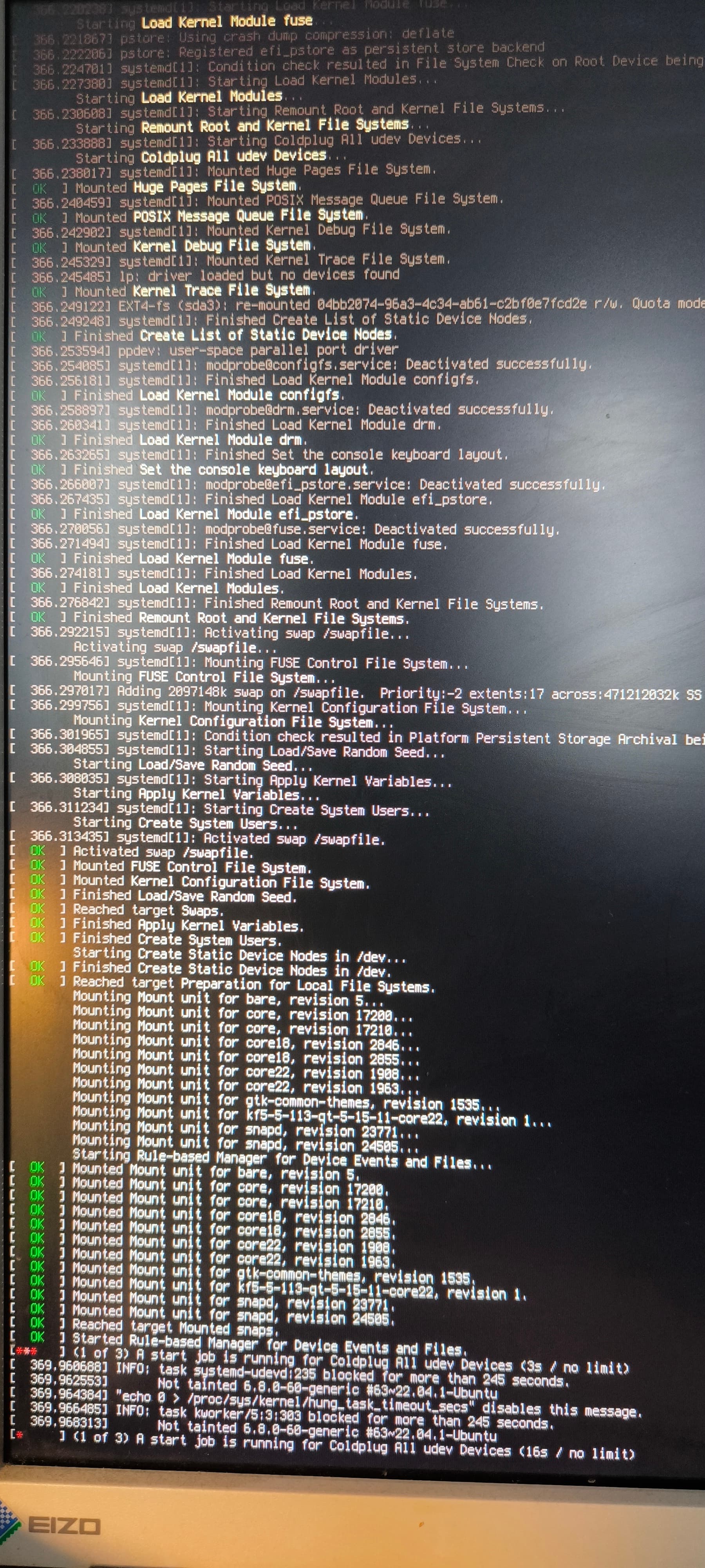

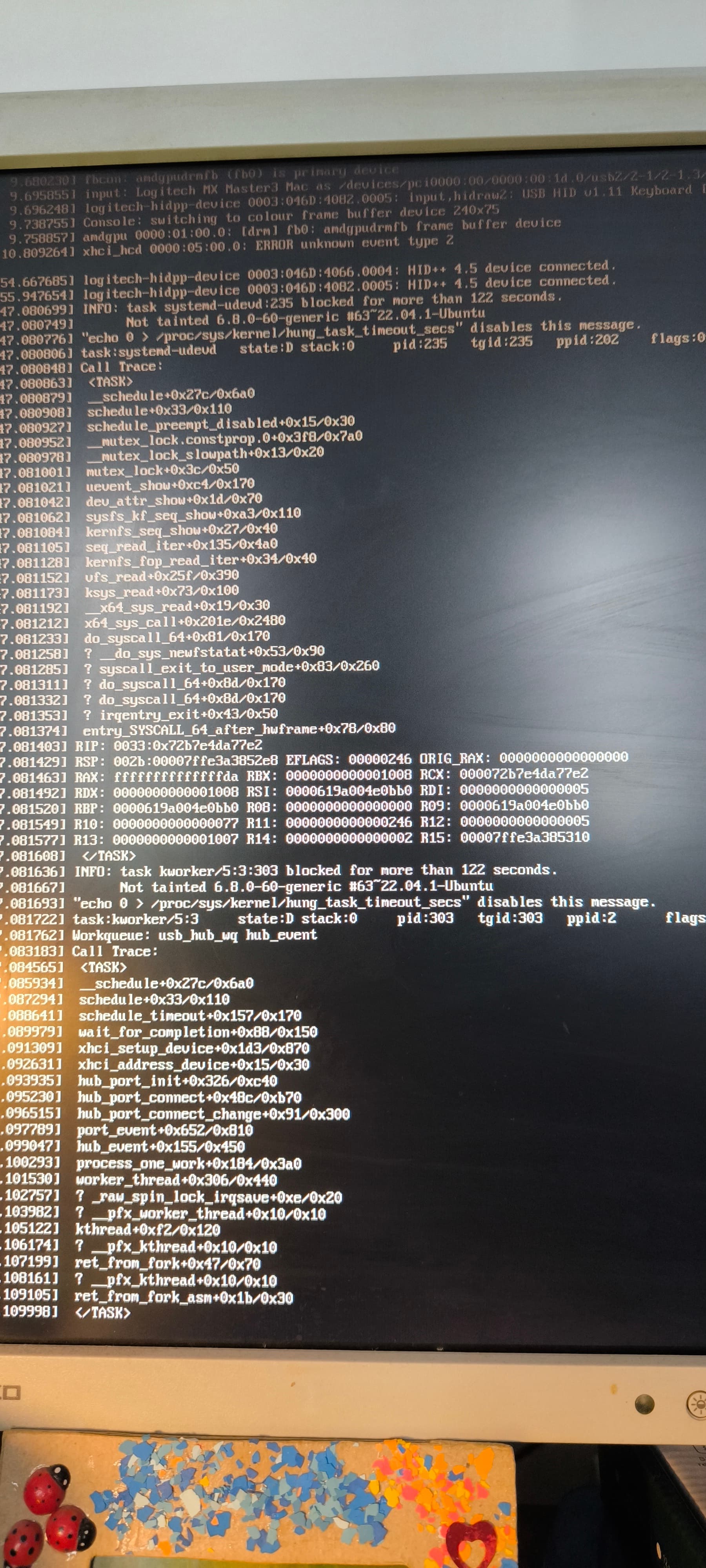

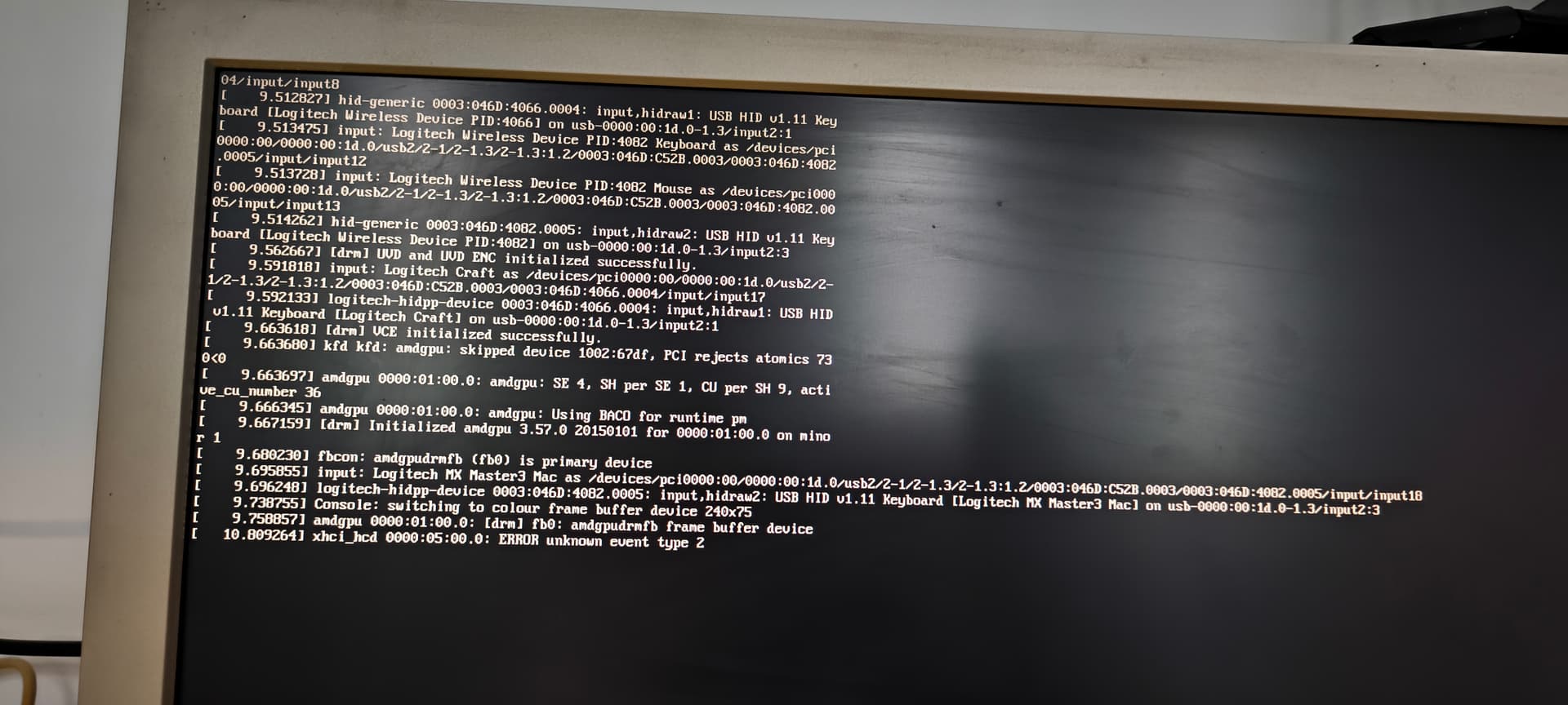

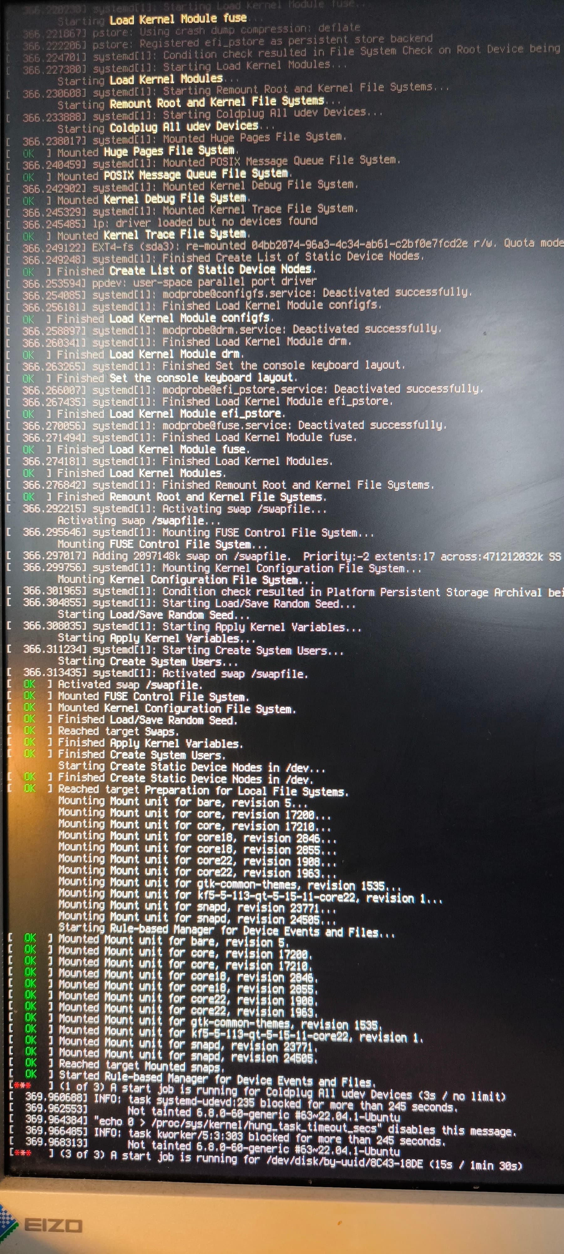

I'm pretty new with zorin. Just wanted to share with you and if its possible to help that my PC is stuck at loading with kernel 6.8.0-59 and 60 (kernel 6.8.0-52 still loading good) and i don't know what is the issue as my last touch with linux and similar OS was looong time ago. i will try to attach some pictures on load if someone can help.

Thanks its done :wink:
on the first page i have to wait about 5 min.
on the second one another 3-4 min.
and onthe last ones i wait a lot and its not going further
