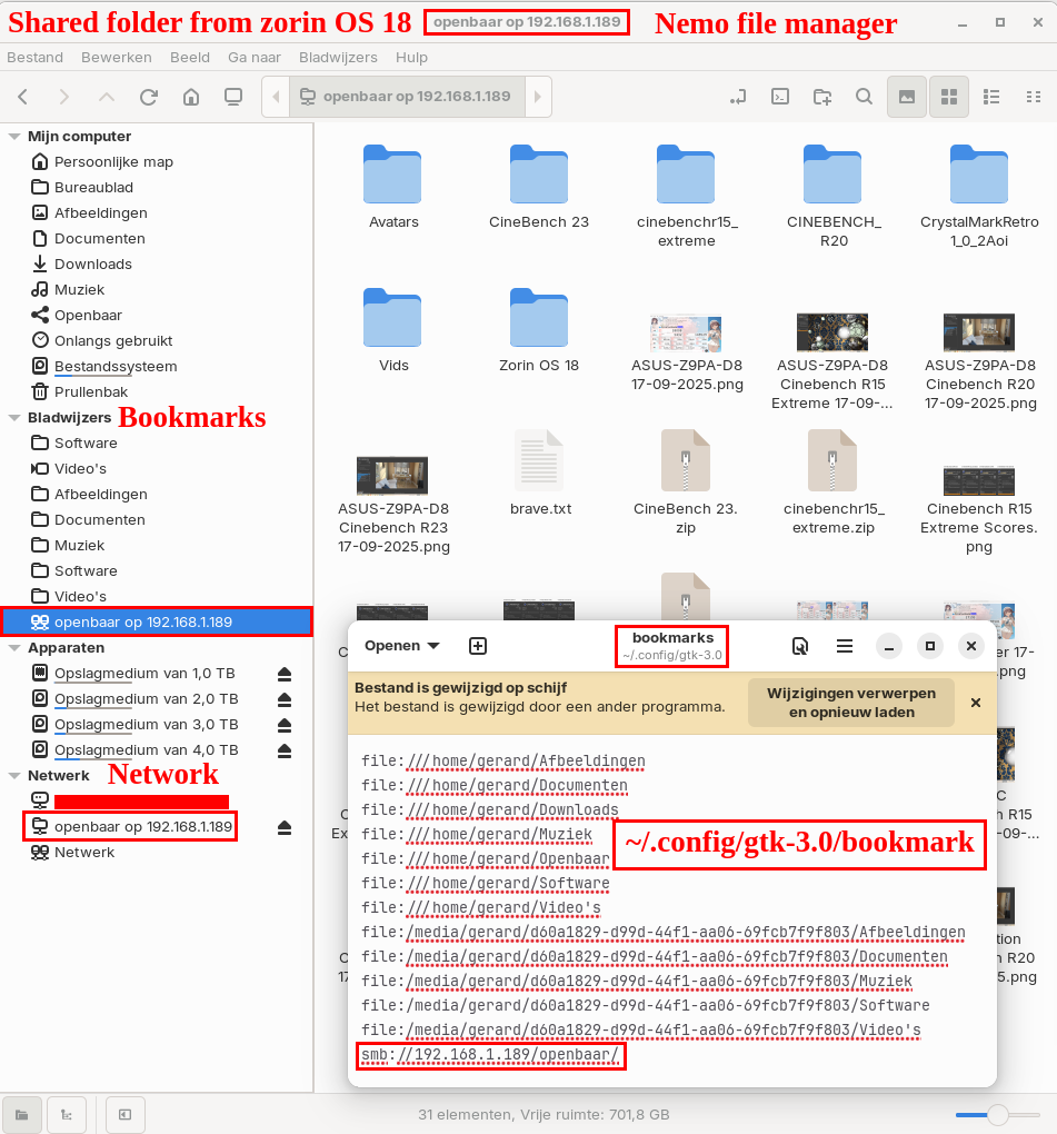

Network sharing is also possible with this text input in your file browser adress bar:
smb://PC IP address/Network folder name/
Where PC IP adress = Your PC IP adress and
Network foldername = Your network folder share name.
For Example: smb://192.168.1.252/openbaar/
If you put this line: smb://192.168.1.252/openbaar/ in .config/gtk-3.0/bookmark the added network share will appear in your filebrowser under "Other Locations" (for Nautilus) or "Bookmarks" (for Nemo).

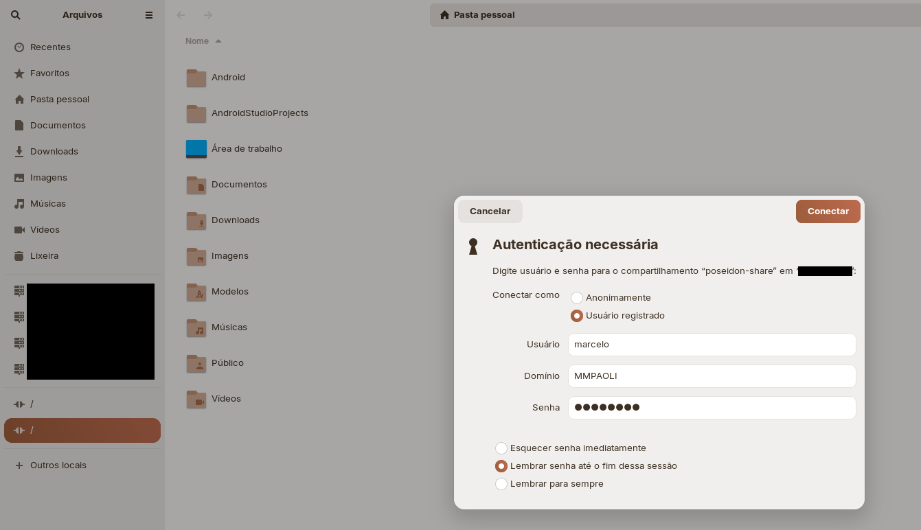

Obrigado pela ajuda De-Witte, mas não funcionou.
Mensagem de local inexistente.

Strange, it works for me though
Hereby my network folder from Zorin OS 18 in the Nemo file manager, added by the bookmark file in ~/.config/gtk-3.0/bookmarks

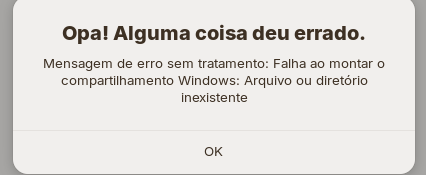

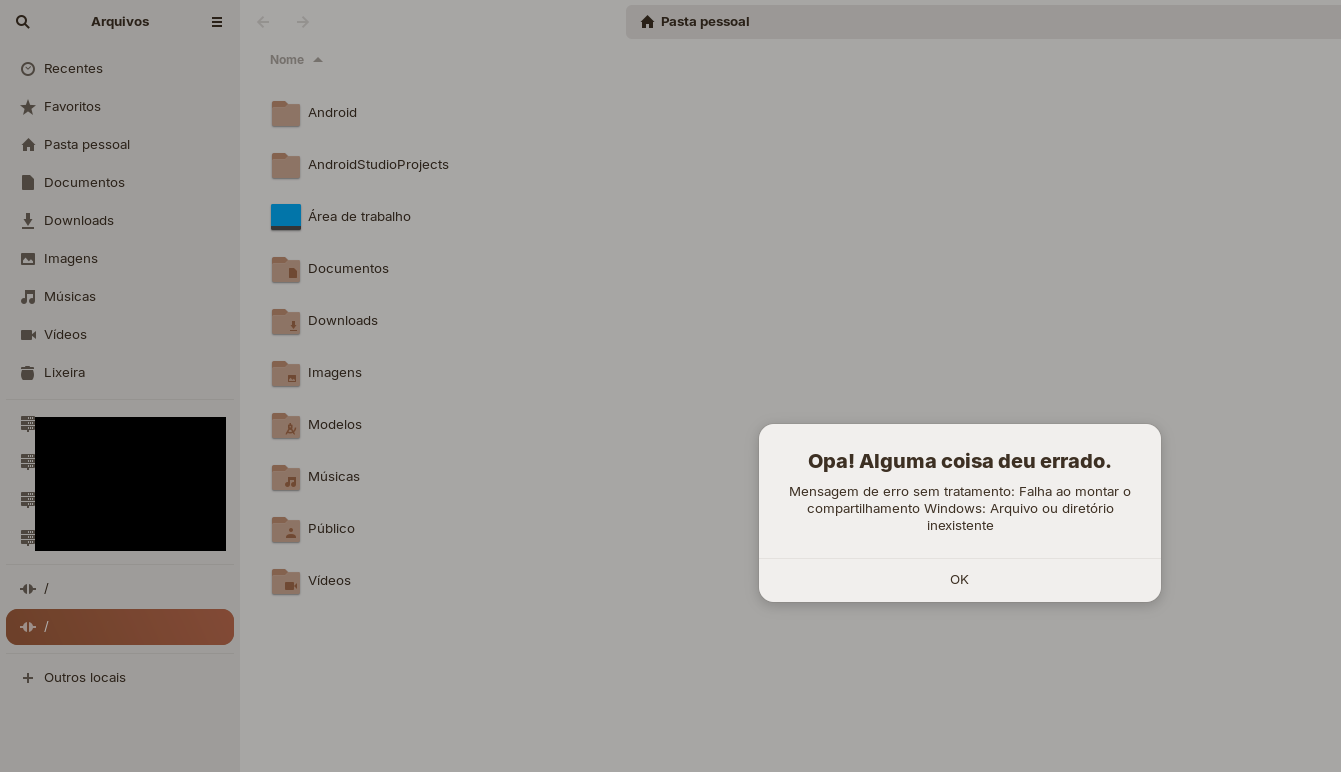

Sem Problemas
Mensagem de erro sem tratamento: Falha ao montar o compartilhamento Windows: Arquivo ou diretório Inexistente
Sure, no problem
Unhandled error message: Failed to mount Windows share: No such file or directory

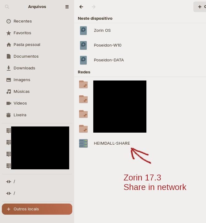

O que eu considero muito estranho é que as pastas compartilhadas do Zorin 17.3 estão visíveis em rede.
What I find very strange is that Zorin 17.3 shared folders are visible on the network.

Were those locations already accessed from this computer previously?
Yes, the shares in Zorin 17.3 have already been accessed with Zorin 17.3 and also with Zorin 18
