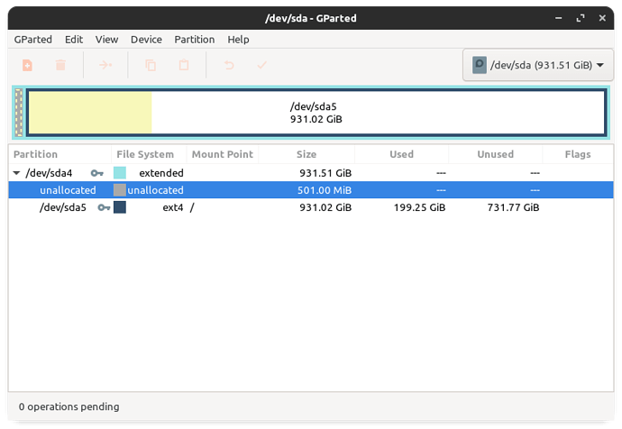

Guys good news. GParted helped me extend the main partition over the last partition.
Now it looks somewhat like this
The problem now is that i want to extend the partition over the unallocated space behind my main partition.
In our case, I created another primary partition behind this extended partition and tried to move the partition trapped inside the extended partition to that new primly partition.
As I said before, nothing worked.
That unallocated looks like it used to be an EFI partition or a recovery partition. 500 Megs?
I think he meant to use the unused part of the current partition. As you know if the whole thing is in a primary partition, it is a piece of cake to add another partition. But currently, the installation is "trapped" within an extended partition. For me there is no escape.

and @Aravisian you are right that 500 megs are efi recovery, which i formatted fully.

If you wish to utterly reclaim space in gparted, select the Space you wish to modify, then hit the (-) button to Delete The Partition.
Then use the resize tool on your existing other partition to slide it into that space.
He cannot.
All his OS and personal date is on this trapped partition.
And if he makes any mistake, he will be in trouble with his dad.
The 500 meg one.
He will not be able to install another OS on such a small partition. He wants to install Ubuntu along side with Zorin.
