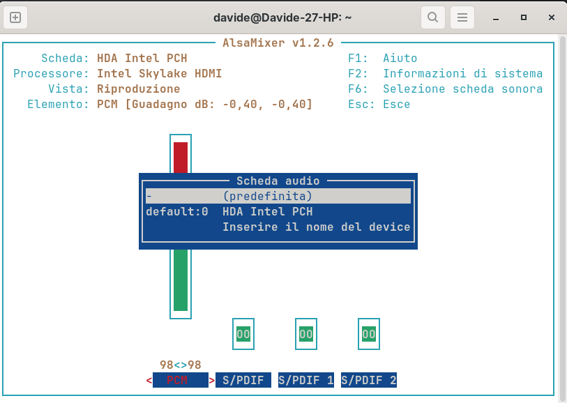

Anyway - in alsamixer, what's displayed when you press F6? Like my iMac, the HDMI / Lightning bolt port is set to defaults but the internal speakers still have issues and can't control the sound as normal; all through alsamixer.. Just curious - wondering if you're experiencing what I am with my iMac sound card. .
This is with F6. I've changed to HDA Intel, but still silence.
I just looked at your alsamixer screenshot. See you have Intel Skylake HDMI sound. I have seen numerous itemes recently reporting sound issues with Intel hardware. Some say sound failed only after updating to Ubuntu 22.04 (base of Z17).

How about headphones - do you get audio through the headphone port? May have to use some external speakers like I have to.. and yeah was reading up on that sound chip; not exactly.. ideal, in terms of those who tried to fix. I see one disabled the graphics accelerator .. to get sound - and one commented, "that's like closing your eyes to hear.." lol... definitely not what we want to go down..
Try some headphones, see if sound comes through the aux / line-out / 3.5mm..
