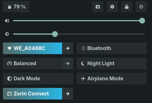

Unwanted gradients appearing when applying any custom theme
When I install any custom theme, I get many gradients that are not supposed to exist. Here is one of the examples
You will see it in Wifi and Zorin Connect buttons
How can I solve this issue?

I found a solution to the gradient issue a while ago. You need to enter the custom theme you are using and find a gnome shell css file, then modify it.
I don't think it's gnome's problem per se, but I could be wrong. The reason it happens with Zorin specifically is because Zorin's shell theme specifies the end gradient with this blue color that shows up. Custom themes do not specify it in any way, whether to remove it or to add a different color to the end gradient. Very few themes do, like the Lavanda theme. This is why my fix includes setting the end gradient to "none", you need to explicitly override the value added by Zorin's theme.
Now, how does Zorin's blue end gradient get applied even when using a custom shell theme? I think it's because Zorin's Blue Light theme is made the default in a different way - remember that as soon as we boot our PCs on the login screen, Zorin's Blue Light theme is used and not any of our custom ones we use.

It really worked!
