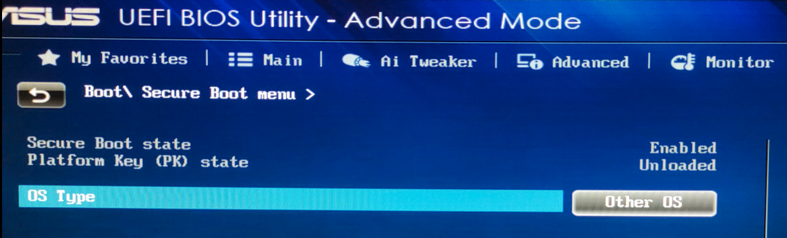

Having followed all the above instructions, I still get error messages. You can see at the bottom of the output that I typed the 'uname -r' to show that I am using 6.8, but the error message still makes reference to '6.17.0-14-generic'.
I had set the default kernel per @Forpli's instructions.
Strangely, my second monitor suddenly started working after I changed back to 6.8 in the grub menu before attempting the latest driver update, so there's at least something positive happening :sweat_smile:

Is Secure Boot disabled in your BIOS EFI settings?
Instead, use:
sudo apt install linux-image-6.14.0-37-generic linux-headers-6.14.0-37-generic linux-modules-6.14.0-37-generic linux-modules-extra-6.14.0-37-generic
Once installed, boot into the Zorin On 6.14.0-37-generic option.
Start with a Fresh and Clean build:
sudo apt remove --purge '^nvidia-.*' '^libnvidia-.*'
That clears out any remnants.
Then install:
sudo apt install nvidia-driver-470 nvidia-dkms-470
Yes I believe I disabled it early into this saga. I'll double-check and then follow your instructions
I've just double-checked and suddenly remembered that I previously tried to disable it, but couldn't find a way to do so in the BIOS EFI settings, and had to drop everything to go to a hospital appointment. I completely forgot that I hadn't managed to disable it :grimacing:
As you can see from the photo I took, the option to disable it is greyed out.
I'll see if I can fish around for some answers on how to disable it, because this could be the cause of many of the problems!
Forget that last comment about me trying to find a solution to switch off secure boot - I've just found the command: 'sudo mokutil --sb-state', popped it into terminal, and it switched it off!
I'll look at doing the other parts of your instruction now.
This command doesn't switch secure boot off, it only shows if secure boot is enabled or not.
But as you have set in your BIOS the OS type to "Other OS", it should already be disabled, or not?
That command on its own, does not - it can show if it is enabled or disabled.
But sudo mokutil --disable-validation can disable Secure Boot from within the terminal emulator, without needing to boot into BIOS Settings.
I followed this after making sure Secure Boot was disabled, and produced more error messages:
