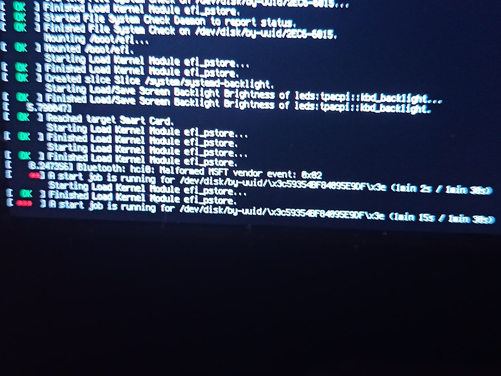

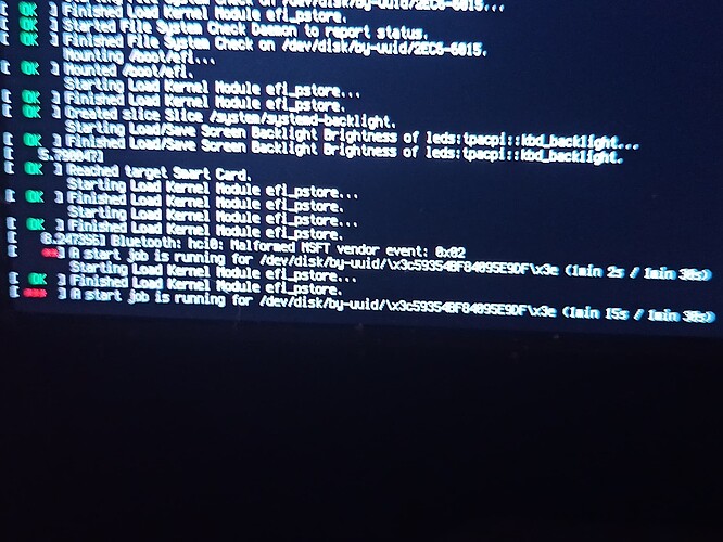

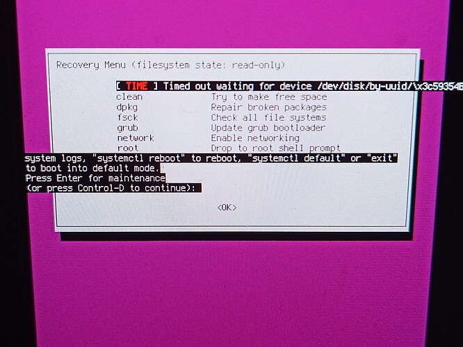

This is where i ended up getting to

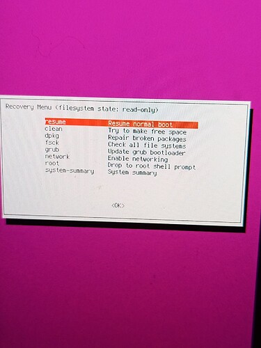

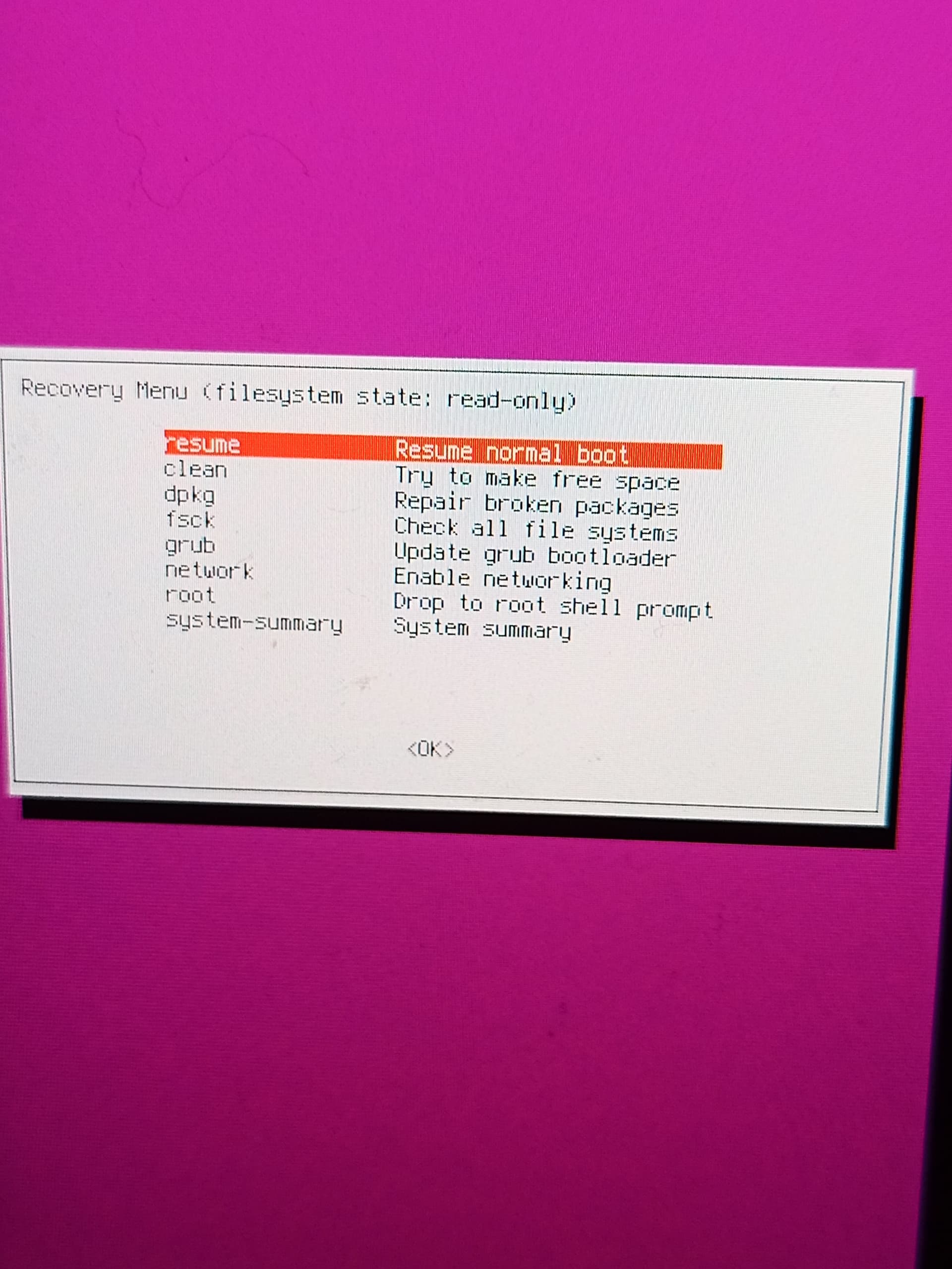

Root - drop to root shell prompt
Cant navigate. Arrow keys arent working...
Ok, we need to solve the USB boot issue, then,

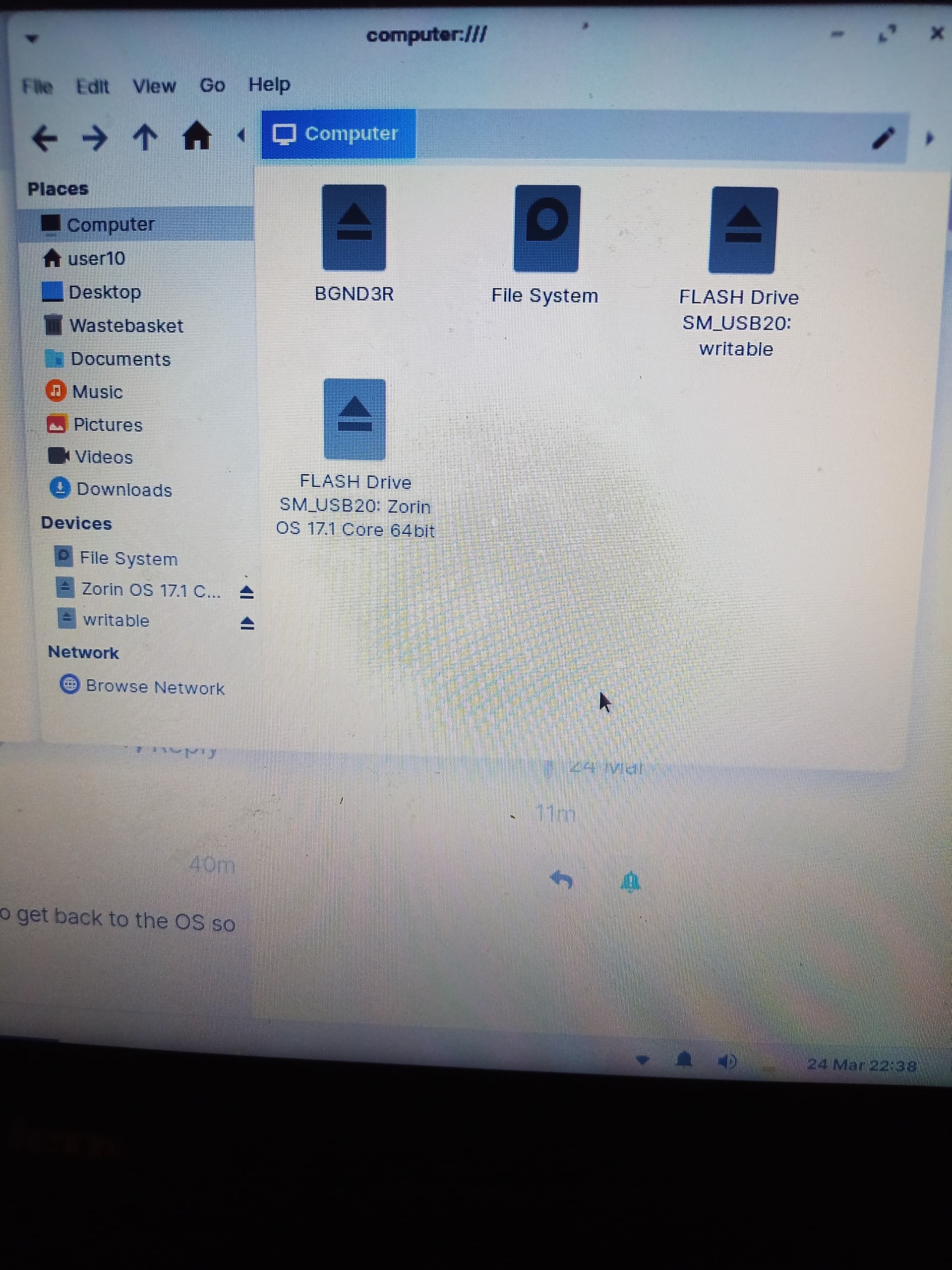

Little confused by this... not sure which is the flash drive here as i plan to clear and format it ready to reflash
If this is the same you used to install Zorin OS with, it looks like it is the last option listed: SM_USB20 Zorin OS 17.1

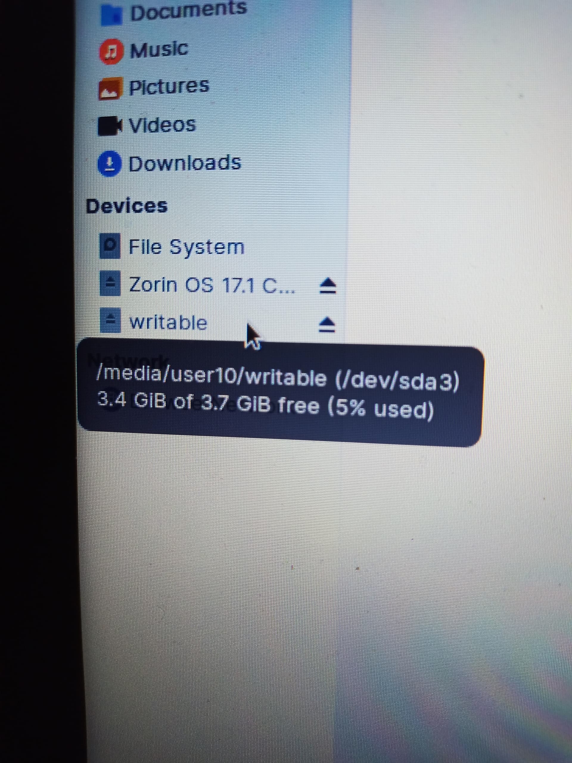

Sorry forgot to mention: i don't have any other flash drive inserted...In fact this usb is the only external device connected which doesnt appear to be what is shown here

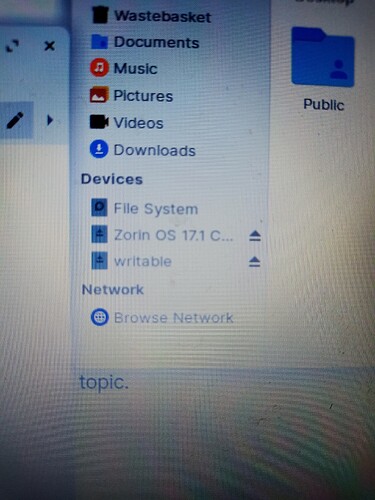

The USB drive is coming up as a two separate drives.... i'm a little confused as i'm not sure which to format and flash?
It looks to me like the one marked as Zorin 17.1
You can check the size of the drive as an indicator as well.
Seems that the drive is being read divided as two separate drives....why is every step throwing up another problem every time! ![]()

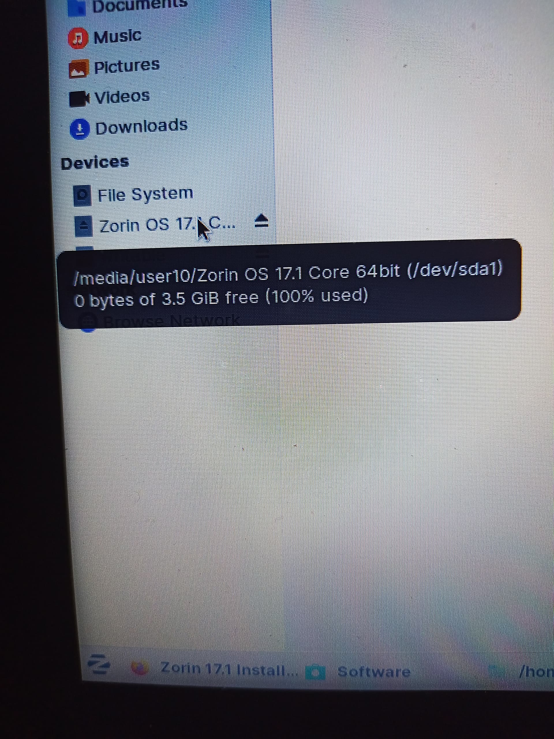

Thats what ive tried to do...but how do you wipe a drive and burn onto it when its being presented as two.... divided they are both 3.5gb...Zorin needs a minimum of 4gb.

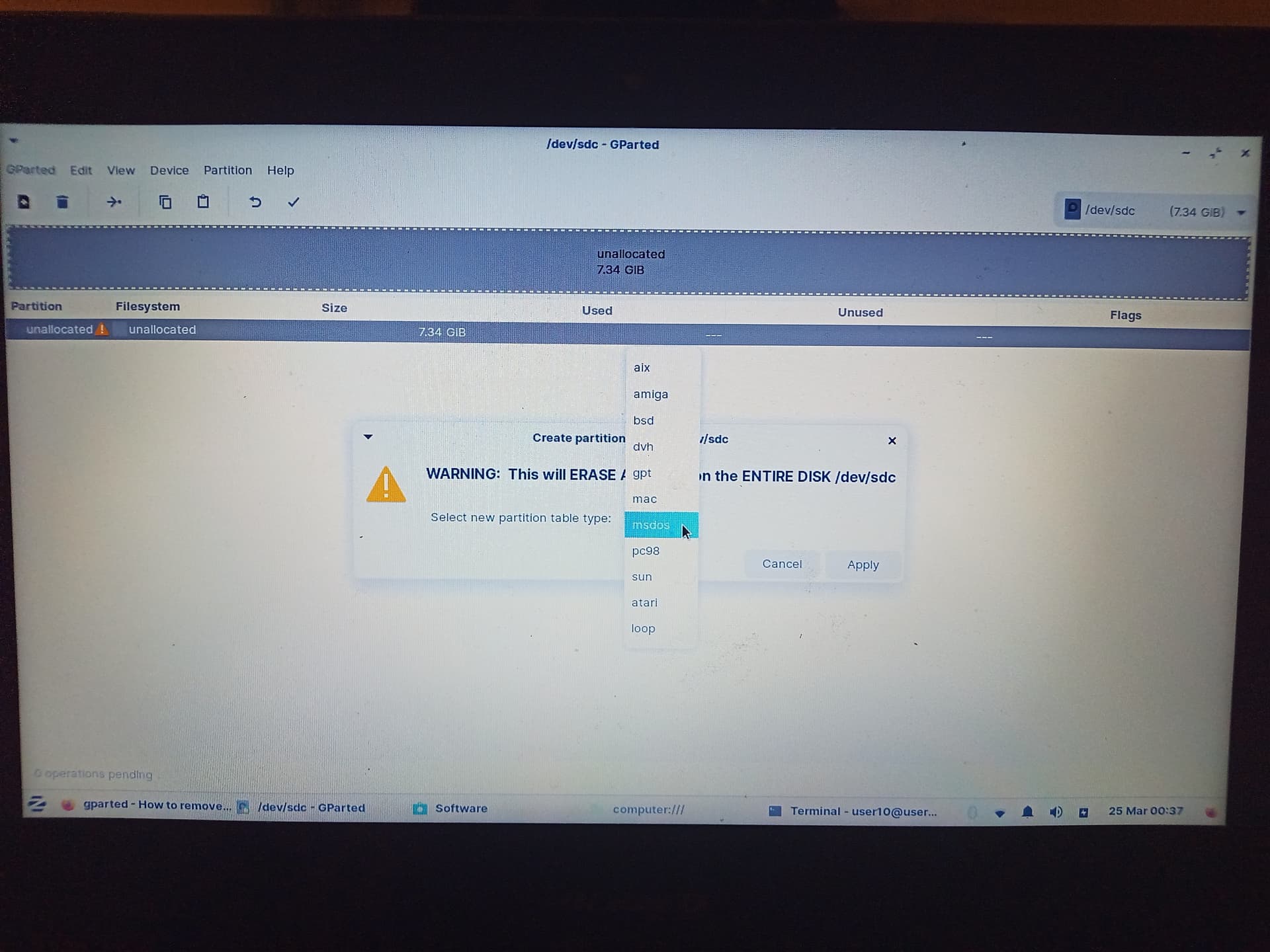

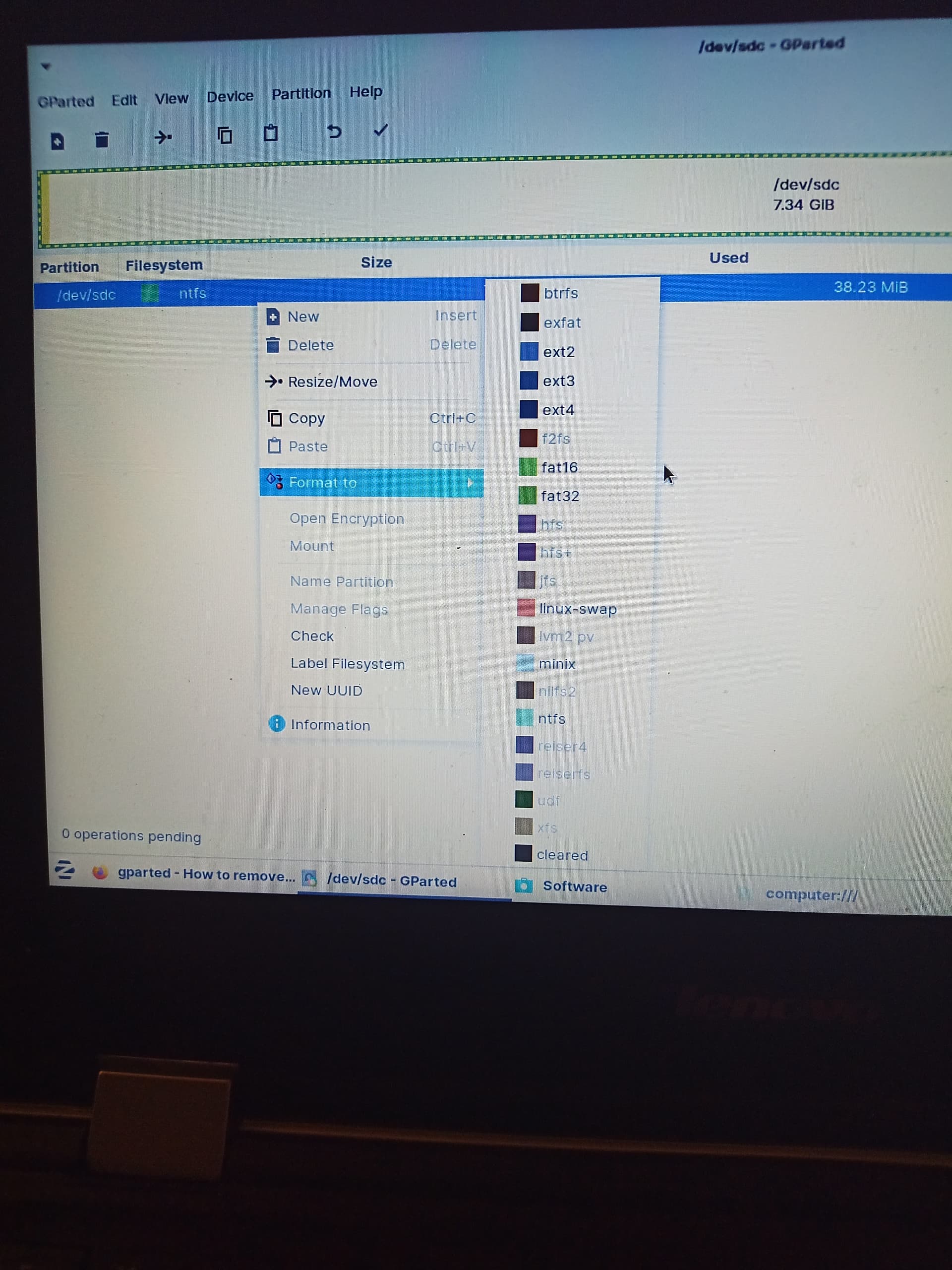

Ok, yes other machine is Zorin too. its showing as a single drive in gparted already fortunately. There's no "ex-fat" option? Its greyed out.
FAT32 will work. It has a max size cap of 4 gigs per file, which is why I defer to exFAT is all.
GPT is fine.
