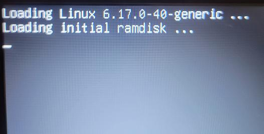

So in the GRUP menu, I tried to revert back to 6.17xx and after selecting it
does nothing except show the following 2 lines of code.
The only way for the computer to work now is by choosing either of the recovery kernels, of which it keeps showing a blank screen upon subsequent restarts.
Ughh!!!!

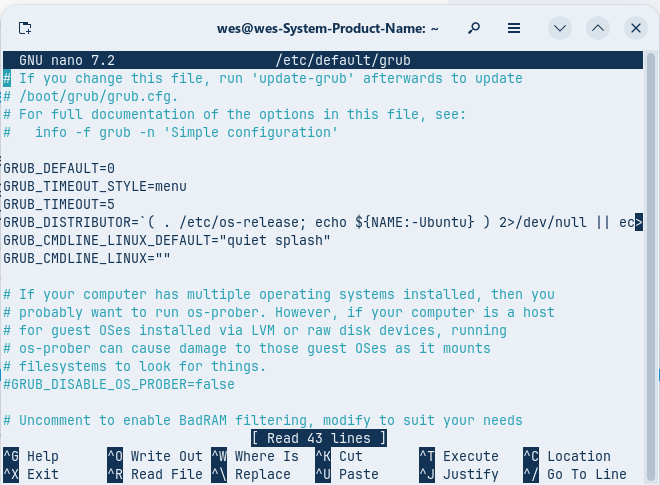

Have you tried nomodeset parameter, yet?
The current value is this:
GRUB_CMDLINE_LINUX_DEFAULT="quiet splash acpi=off"
Do I change it to this?
GRUB_CMDLINE_LINUX_DEFAULT="quiet splash acpi=off nomodeset"
Thanks as always
Exactly. Then,
ctl+o, enter and ctrl+x. Run sudo update-grub
Do a full cycle reboot - then test booting normally.
