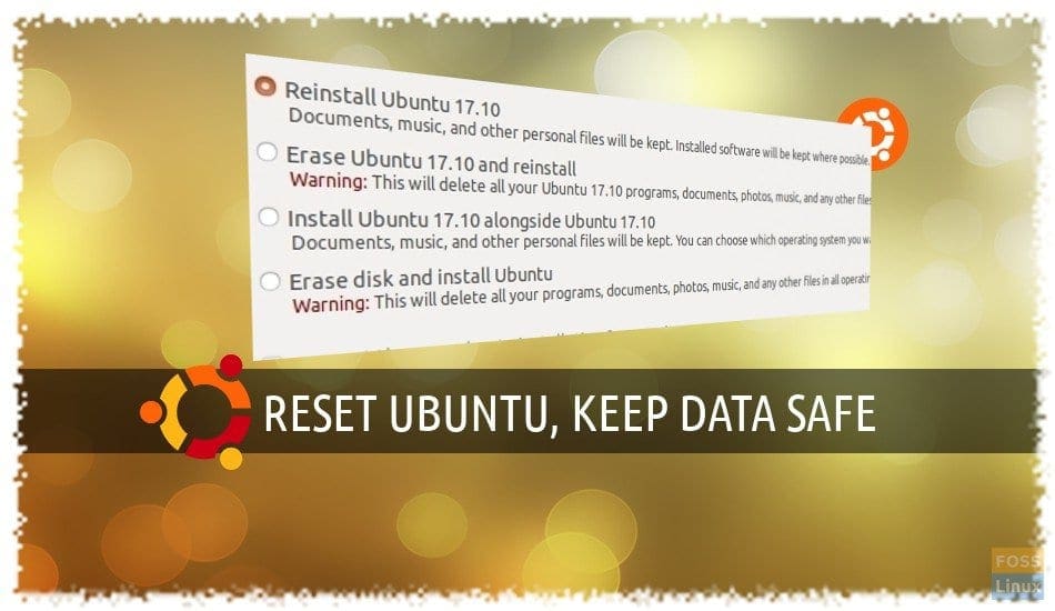

I did that before... Is there a way to reinstall the os so that all the programs keep working? I assumed everything I do goes into my home dir, but apparently not. What root directories do I need to backup to keep everything?
This will be a great step, please think before you use it ![]()
Didn't do anything...
Zorin installer doesn't give a reinstall option, so I will have to star over again....
