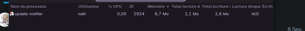

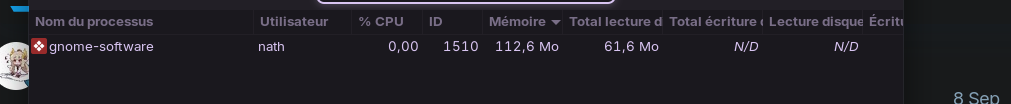

Can you try to open system monitor to kill Software & Updates and gnome-software? I'm not sure what the name is there.
I only have these in my system monitor :
I'm not sur it's this, and even by restarting I can't launch software and update :frowning:
