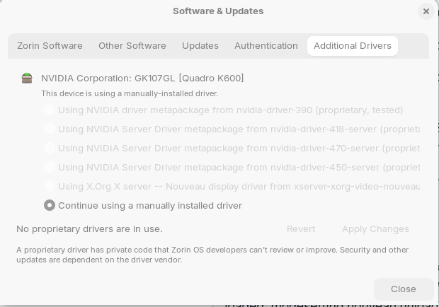

I've tried running the system updater & selected additional drivers but they're all greyed out & I can't select them
I'm running 64 bit Zorin OS 17.3 Core, graphics uses a Quadro k600, which should use the 470 driver listed above and until about half an hour ago it did

I ran the system updater and all the Nvidia drivers are still greyed out

Further info "ubuntu-drivers devices" gives
== /sys/devices/pci0000:00/0000:00:01.0/0000:01:00.0 ==
modalias : pci:v000010DEd00000FFAsv000010DEsd0000094Bbc03sc00i00
vendor : NVIDIA Corporation
model : GK107GL [Quadro K600]
manual_install: True
driver : nvidia-driver-390 - distro non-free recommended
driver : nvidia-driver-418-server - distro non-free
driver : nvidia-driver-470-server - distro non-free
driver : nvidia-driver-450-server - distro non-free
driver : xserver-xorg-video-nouveau - distro free builtin
Which recommends the 390 driver, my apologies I could have sworn I was using the 470
I looked at Nvidia's Website and for this Card, You can use the 470 Driver. The interesting Thing, I saw now here: They only offer the -server Driver.
When You now want use the 390 Driver, You would have to install an older Kernel because the 390 Driver doesn't work with the 6.8 Kernel. Do You want do that?
Won't the next update, update the kernel & put me back to this situation ?
No, when You stay on the older Kernel, that shouldn't happen. Of Course 100% Guarantee isn't possible. You would install the older Kernel and then the Nvidia Driver, but via Terminal. There we can with a Command installing a dkms Package which is for Kernel Updates. That sets up the Driver when a Kernel update comes.

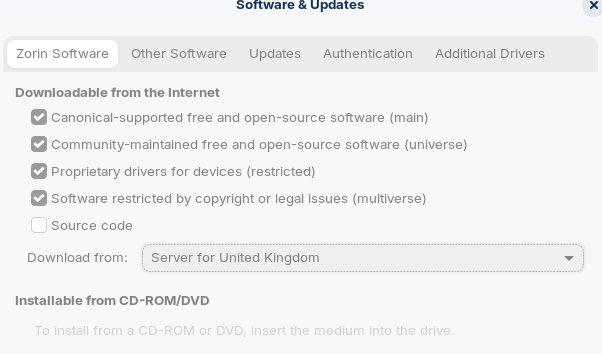

Also, looking back to the top of this thread. Can you confirm your Software & Updates source is set to "Main Server", not a local or regional server.
The "Software & Updates" dialogue "Zorin Software" tab looks like this
Does that tell you what you need ?
Yes. Change that UK Server to "Main Server" for best results.
