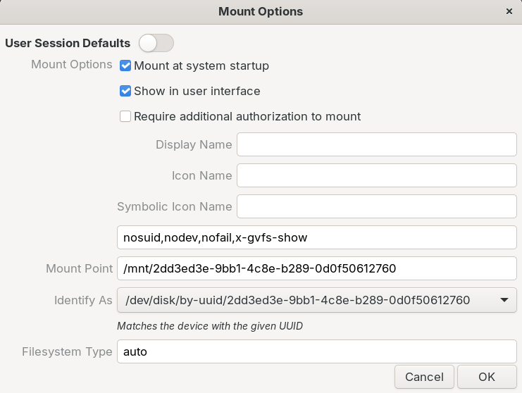

Can you share a screenshot of what that looks like for you? Note that you have to disable the first option "Use Session Defaults".
It's probably best to unmount the drive before doing this, by the way.
An example, for reference:
Here's a screenshot of the drive.
That looks all fine. So, with those settings, what is the output of that same command from earlier right after you restart the computer? Don't do anything else, just launch a terminal and run lsblk again.

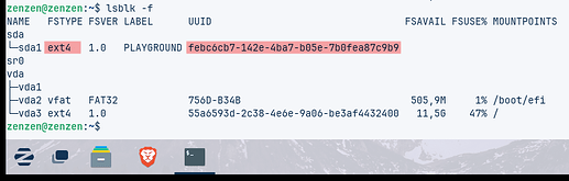

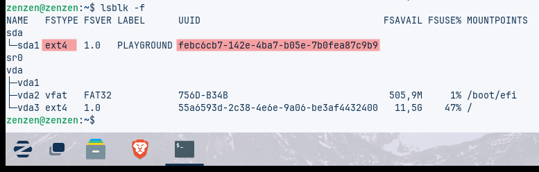

  1. First you need that long string of characters, the UUID which is an identifier for your drive. You can find this out by running this in a terminal: lsblk -f — very similar to last one but with an extra option.
    Copy the value from that UUID column and paste it, and make a note also from the FSTYPE column which you'll use in a minute.

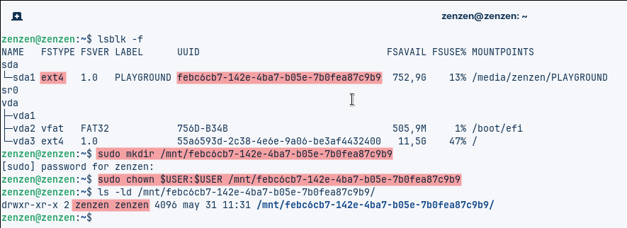

  2. You need a mount point, or where this drive will be visible in the file system. Let's create that somewhere predictable so that you can come back to it later if you ever need to. I'd suggest the /mnt directory similar to how it appears in your last screenshot from Disks.
    In this case, I'm just copying and pasting the output from the previous command:
    Note that you need to run sudo and that will mess up permissions, that is why I'm running the chown command to change ownership to my own user. You can take this a little further if you share this computer with other people and run: chmod 750 /mnt/febc6cb7-142e-4ba7-b05e-7b0fea87c9b9. This will make it so that only you can access this directory.

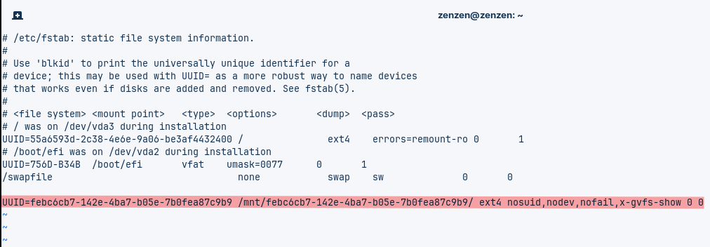

  3. And that's about it, you have all the information you need to add that entry in /etc/fstab:
    It looks long and intimidating but you can just copy and paste a lot of this. Note that the file system (the third column ) comes from the FSTYPE column on that previous command. The options, are the same as they appear in Disks and the other two options at the end leave them at "0".
    Make sure to only use spaces between each of the fields, this is important. And, if you have any questions, is better to ask!
